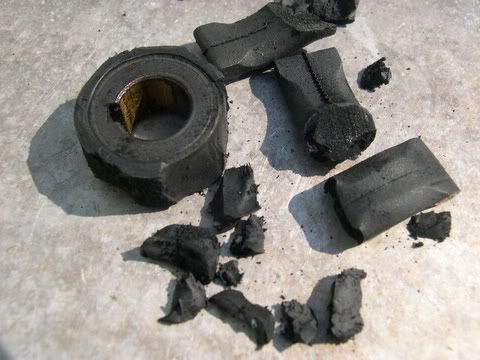

My new impellar self desructed today. I have never seen one completely destroyed like this? It went from being 6 vanes brand new (2 days ago) to a powder form with 3 pieces I can recognize as vanes.
The remains!!

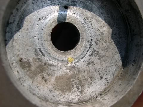

Inside the aluminum pump housing
I know it will be over a week before I can get a replacement due to the 4th of July (places and shipping being closed) :(
Any ideas on why? I had the lower unit submerged in a drum of water when I started it?
I have done quite a few over the years and this is the first one I have ever seen turn to dust. I cleaned out the passages, pick up and exhaust and got piles of rubber particles out.

I'll bet the pump wasn't submerged. That groove worn into the housing would prevent it from sealing well enough to draw water. But if water were in there from being submerged, it should've primed well enough to continue. You need a complete pump.
