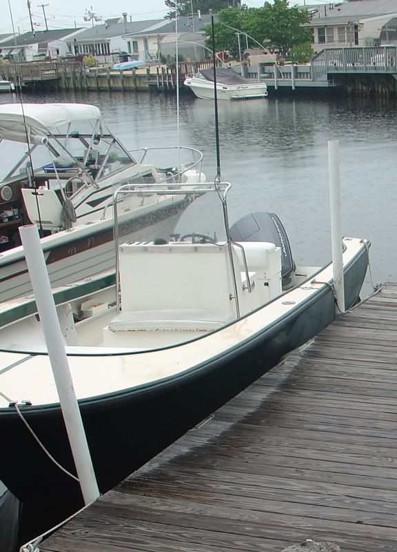

Been looking for a boat for a while now and found that my neighbor has one that he wants to get rid of. I dont know the name of it but its a 20'. When he bought his, he bought 2 and this one just sits there. This is his boat.
Now, it has no trailer, whats the best places to find one and how much am I looking $ wise?
Also, my tow vehicle is a 2000 Nissan Quest. It has a V6 and has been towing bikes and jet skis no problem. I know that this is a different league and thats why I was wondering. I am about 2min. away from a launched and it would be put in, in the spring and pulled in the fall. Would I be okay or would I have to go some other route?

Re: Will this work?
