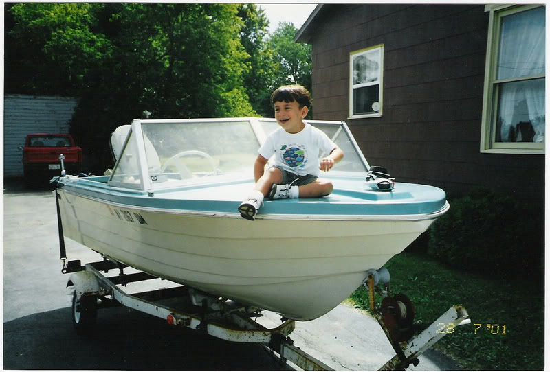

The boat pictured is the boat I need to tow. It is a circa 1963 15 foot sea sprite, it is fiberglass. The trailer is probably less than 200lbs, and I can pull the trailer out of my garage with the the boat on it.
As it is the middle of winter here in NY I can't easily weigh it, and I have no idea what the tounge weight is on this boat, I know it is light.
I am looking at buying a new vehicle and am not sure if a 4 cyl small suv will haul it. I'm looking at the honda crv, the ford escape and the toyota rav4 . All of which are easy to find in 4cyl. the Rav4 only came 6cyl in 2006 and beyond. As I'll drive the car year round, and only tow in summer, I want a vehicle with better MPG than the big SUV's.

Don't I see a pickup in the background? Keep the truck for towing. Buy what you need for economy. Economy can be elusive if you ruin the small SUV because it's not up to the task. Remember, it isn't just the boat and trailer that counts toward towed weight. It's the extra stuff you put in the boat, in the vehicle, and the people as well. Even the current year Honda CRV is only rated to tow 1500 pounds. That boat, trailer, gear, engine and gas will put the total at or very that limit. Then there is the brake issue. Just because you can tow it does not mean you can safely stop the load. I think you are at least in V6 territory even with a small SUV. On the other hand, if your trips are very short and primarily to local ramps or marinas, that's one thing. But if you need to travel longer distances and through hilly terrain, I suggest you at least test tow with a neighbors vehicle or at least think through your use and options more thoroughly.

the pick up is not mine--
