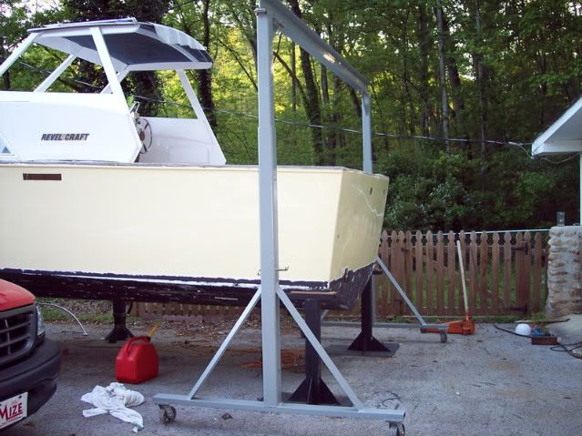

I thought you all might like to see the finished product. I started on this little project last month. I will be using it to remove the engine from my old tug as well as some side work I have been doing around here. I have wanted one for years but never wanted to shell out the clams it takes to buy one. I built this one from plans I found online. It is twelve feet wide and is adjustable to twelve feet high. According to the plans it has a 3500 lb. capacity. It should be plenty to do what I want as well reloading the boat on the trailer when the time comes. It came out pretty well.

Very nice. Can you post a link to the plans, as well as a rough cost estimate?

Yea, that'll work!:) You could turn it into a swing for the kids when not using it too.:D

Here is a link to the website where I got the plans.
http://www.synthx.com/shop/index.php?cPath=6
According to my receipts I have $740 in steel, wheels, primer and paint. I used a small stick welder I own (buzz box) to tack everything together. A friend at work, and our shop's welder, was kind enough to stay after work and finish the welding. The rest was done by yours truly. $740 bucks seems like allot but when you consider gantries of this capacity and adjustability start at around $1800 and go up, I'm doing ok. Thanks for the compliments.

Good Idea! You think twelve feet is too high for a two year old? My seventeen year old has already done chinups on it. :mad:
