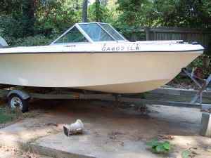

Lets show some photos:
These are the photos from craigslist. I got it for 300 if I recall right. The motor had one carb off. I was also told the original owner used it in salt water. I took it anyway and I was able to put the carb back and fire the motor without much problem.
