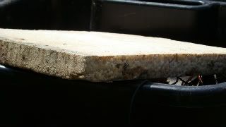

Two topics here. First off is where do I find sheet foam? I pulled out a bunch of this stuff from between the stringers under the deck:
It's about 2" thick and 12" wide. I walked around Lowes this morning with no luck.

For the foam you may want to try a more contractor friendly building material dealer. According to Lowe's web page, they offer only 1/2" thick material.
I would think that either the pink (Owens Corning) or the blue (Dow) extruded foam would work. Don't use the beaded foam as it will absorb moisture more than the extruded.
People here used extruded foam for dock flotation until it was outlawed.
