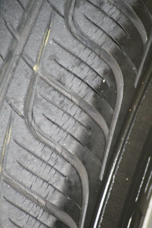

I will be making an 80 mile trip on the interstate at 70mph tomorrow to go get a new rolling tool cabinet. The tires on my truck probably only have 8000 miles on them, but they are 9 years old and are doing this around the edges. The sidewalls are fine, the cracking is only on the tread itself, and only on the edges. I took a photo so you can see them. Do you think these tires are ok for a round trip 160 miles at 70mph?
I never go anywhere on the interstate, it's an around-town truck, so I never had to think about it until now.
What say you, Iboats?

How heavy of a load? If you are near max weight with that box NO WAY..... got a home depot near you to rent a truck from? :D
I would make the trip on the tires but they would certainly on my list to replace and NOT with what brand they are now..... unless you go to a dealer and ask about the cracking. Never know they might be known to fail and most tire warranties are based on miles not time. You might have a chunk of credit there to use.

No, the truck would empty except for the box, weight 140lbs. This is on a little Nissan truck, short bed, regular cab. A tiny little truck with no accessories added except a plastic bed box which might weigh 15lbs.

Those are in prime condition for tread separation...
The weather will play into this too...if its a hot day then twice the chance they come apart.
I would drive on them but be easy...

The tires are comming apart on their own without the help of a 70mph - 160mile trip. Is your insurance paid up?

For 80 miles, I would.
I have had to drive on worse than that before.
Just make sure the spare is aired up.

Three years ago I had a michelin tire break a belt and overheat on I95 . AT 70 MPH IT BLEW . I wouldnt trust those tires at higher speeds where you get higher temps, Driving slow 45 mph for short trips would be ok but just too risky on an interstate, I would go to pep boys and get some econo tires .

I wouldn't back out of the driveway on 9 year old tires.

I see cracking between the tread and further in. I would keep the truck for around town only.....

there safe, just showing some age, probably will need to be replaced very soon tho.
