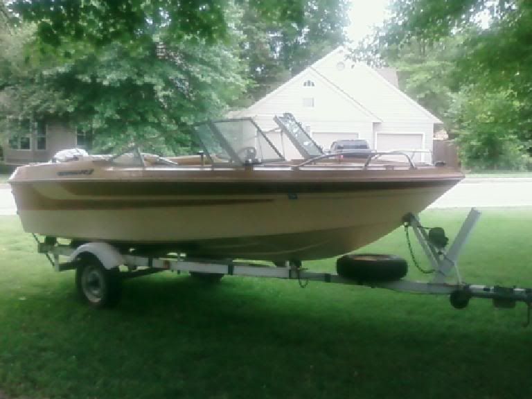

here's the boat......79 starcraft questar
