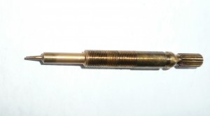

When I was cleaning out the carb, I noticed that the low-speed needle looks like the tip was chipped off, but I'm not sure if this is the way it's supposed to look. I have the service manual for this outboard and it doesn't exactly resemble the drawing. I'm attaching a photo of the needle and hopefully some experts out there can tell me judging by the photo if I need a new needle and perhaps where the best place to order one from.

After putting the kit in the carb. did you do a link and sinc.? Also, did you adjust the slow speed setting properly? The needle isn't supposed to be needle sharp and judging by the picture yours is a little worn but I would guess it's still serviceable. It certainly sounds as though you still have a carb. issue and you might want to give it one more thorough cleaning, followed by lots of compressed air to blow out each and every passage from all directions paying careful attention to the slow speed ports. Best of luck. Rick.
