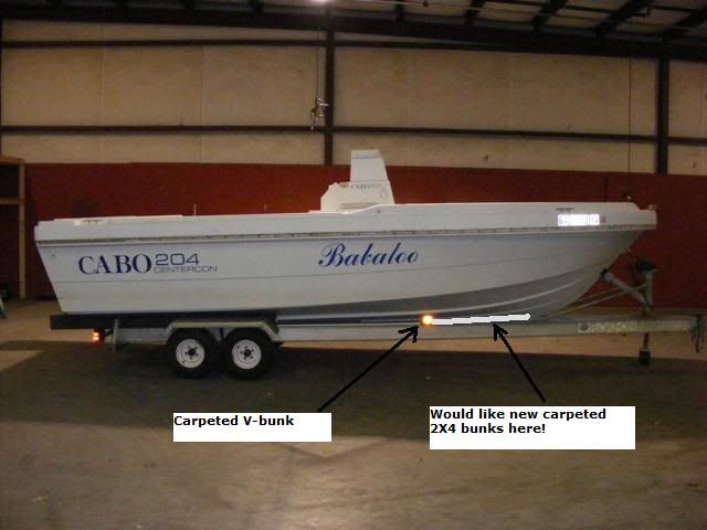

I've got a single carpeted v-bunk on the front of my aluminum I-Beam trailer right now but it's too far back and the wood in it is rotting... I'd like to replace that "system" with two 2X4 carpeted bunks that run from the point of the existing v-bunk, forward 3 or 4 feet (obviously, one for each side of the keel).
I've found the brackets I need that attach to the trailer's front cross bars, but here's the problem... The trailer does not have any cross bars in front! The only one it has is a 2X4X30" "c-channel" that holds the current rotting 4X4 v-bunk.
Where can I find some cross members and what size do you think I need? It's going to be a bit "low" so I'm thinking I might need V-cross members...
I'm open to any thoughts, comments or suggestions with this. The current v-bunk that is on there is causing a hook in my hull and I'm just not a fan of it now!
Here's a picture of the rig:
