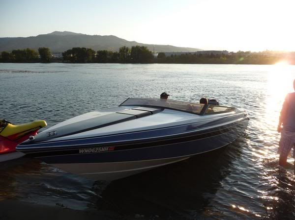

whoa....hold up a sec...your boat seems pretty slick and with a LITTLE bit of tweeks you can get it where you want it. i dont think that merc will mate with omc and besides bravos are for big hp 300+....your 350 on a good day will make 230 and thats giving you some for the thru hull exhuast....hey i like to tweek on mine too dont get me wrong when i tell you that you need to slow down and use the boat a little more before you make some big changes...i can tell you that you can gain a mph or two with a 100$ investment on smart tabs sx....look em up. please dont think i am trying to rain on your parade but like i said i was in your shoes and i smartened up real quick when when the reality of time and money settled in...i paid 12,000 for mine and it was like yours, in wonderful condition...the things that i have done to mine were for speed and pleasure of use.....use yours a little more and you will see what you want....if you want speed sell it and buy a something in that range cuz you will put that much dough in yours anyway
