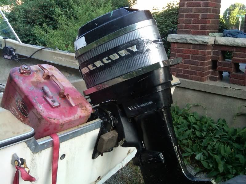

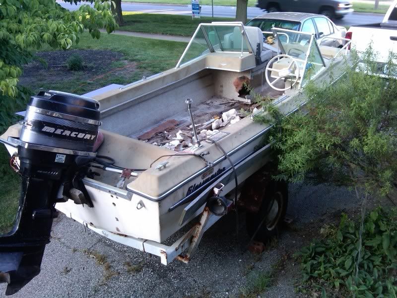

Hi everybody!! Thanks for taking the time to look at my post! I recently got this bastard from a family member of a guy I work for. It sat in the guys backyard for a few years uncovered. He wanted it out of his yard and I towed her away. I spent a few minutes tinkering with the motor and got her to run! Nothing fresh gas and spark plugs cant fix. A few days ago I decided to take it out on a test run just to make sure she floats Success!
She needs new deck as you can see I have started to tear into it realizing that maybe I bit off more than I can chew. Its on craigslist right now for 600 OBO but I plan on continuing work until a buyer? But for the money maybe I can have a good running boat to take the ladies on :)
The stringers look good and solid but as you can see everything else is pretty rotten. The transom seems to be okay but has flex when you push down on the motor :( Do you think I can get away with not replacing it this season? I didn't really want to tear this far into it but I feel maybe it will pay off..

Save motor, scrap boat
Put motor in garage, save some pennies and find a SOLID hull..May I recommend an old Starcraft tinny...slap on motor and go
With a flexing (aka rotten) transom, and everything else in the pics, the motor is the only real value there..

Neat boat. Not bad for the price.
Regarding the repairs, usually the stringers, deck and transom are all done together because they all connect. The transom usually extends down below and behind the stringers, and the stringers get glassed to the transom.
But not all boats are built the same. So if you think you can get away with doing the job piece meal, go right ahead. But its not common.
BTW, it looks like a tri-hull, but with a very shallow hull shape. Probably make a nice lake boat.

I think I'm going to finish my project and restore it..Is there any advice on how to replace the transom? The glass on the inside is completely gone. Should I cut the outside skin off then pull the rotted wood out, replace the wood, replace the skin then epoxy together? Then glass the inside along with the stringers and deck?

You can call it project "lady killer" if you are sure you want to restore it go for it but it IS going to be alot of work and time and money. Hate to sound like a dink but that boat needs alot of work to be seaworthy. A rotten transom is nothing to chance I speak from experience on that one. If you do go ahead with it start by removing everything from it you can like the motor(build a stand to hang it on) controls, cables etc. DON'T cut the outer skin off the transom if there is access do it all from the inside and save yourself a load of work. There may be sections you can't access if that is the case then you would need to remove the cap from the hull, again alot of work but all doable if you have the desire. Above is enough to get you knee deep into it. If it were me I would sell what parts you can off the boat of keep whatever you think you could use on the next one, keep the trailer, motor, controls possibly the steering and scrap the rest. decent hulls are plentiful find one you really like use your motor and trailer if need be and go boating instead of a couple seasons of fiberglass itching and no boating. If you decide to do it all of the questions you will have can be answered here by very knowledegable people.

Transoms are usually rebuilt from the inside, especially when there is no inner glass layer. Avoid cutting the outer glass skin, as it is a serious structural part of the boat. Pull out the wood from the inside and replace from inside. Do a search on transom repairs in this forum, there are lots of them to read about.
I agree the boat needs lots of work. So if you want to go boating THIS season, find a seaworthy boat the same size, and swap over the motor and trailer.
