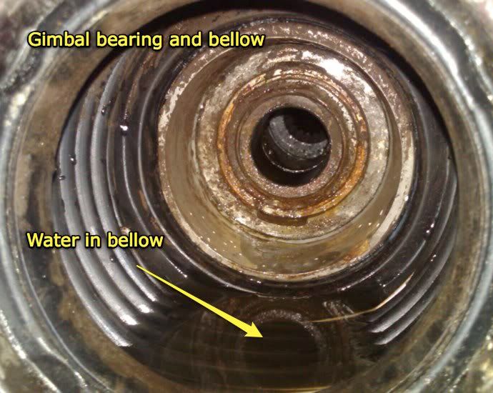

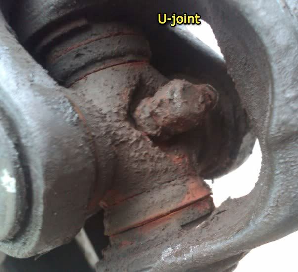

Apparent hole in the Drive shaft bellow, with visible water intrusion. (I'm surprised it never leaked into the bilge). Rusted and SHOT gimbal bearing as well as shot u-joints.
GIMBAL
U-JOINTS

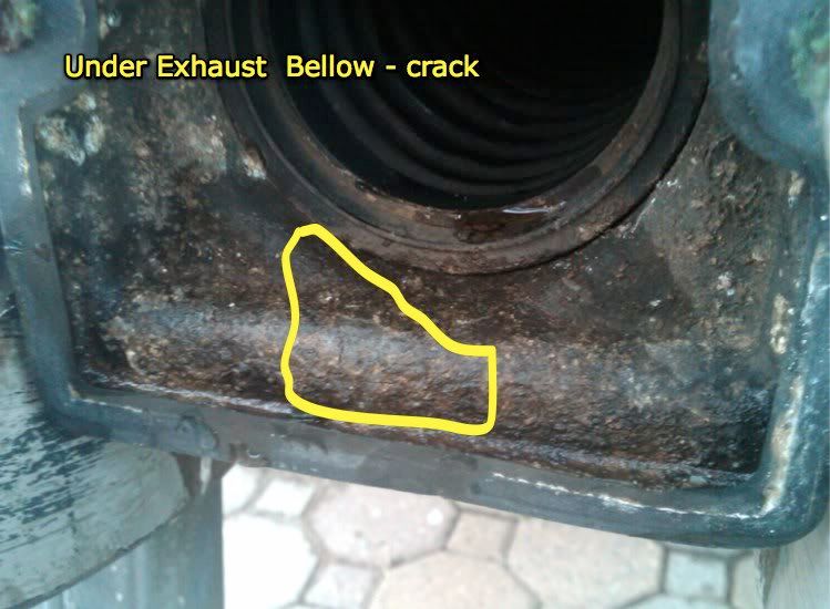

Also found that the right under the exhaust bellow i have a hair line crack in the housing. Could this be a problem? Technically water comes out in that chamber anyway with exhaust.
CRACK

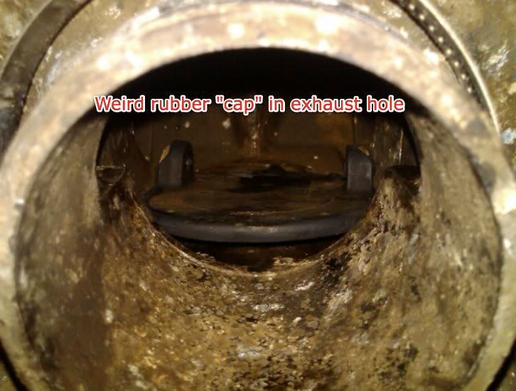

When I look into the exhaust chamber i see a weird rubber flap like piece just laying there. Its not attached to anything and I cant get it out because its bigger then the hole it needs to pass through in order to come out. I'm thinking it was meant as a valve not to allow water to come back in but only to let water out with exhaust. But why would it not be attached in any way? Should it be?
Rubber "flap"
Take a look at the gimbal bearing pic below. In order to take this out do i need to remove the lip marked with the red arrow frist? It looks like it could be a screw in looking at the cut away top and bottom sections. But not sure. Or do i just pull the bearing out at this point as is? Please advise on this.
Gimbal Bearing

Don't worry about the crack near the exhaust bellows.
That weird rubber thing you see in the exhaust is your exhaust flapper. you need to get it out of there and replace it.

The gimbal bearing just pulls out.

The red arrow part comes out with the bearing. :)

So far none of the pictures would indicate a problem with shifting the drive and your so far I don't see anything that would discourage me from continuing on with the maintainence, replace bellows, remove the broken flapper and leave it out, so now with drive off can you shift it into reverse?

EXHAUST FLAP
how was this installed originally? does anyone have a picture of this in the manual? I would imagine that to reinstall it i would have to take off the entire transom mount? Can i just take it out and not use it anymore?

The shift mechanism which you didn't show.Is probably gummed up.The bellcrank needs lots of grease and cleaned every year.The flapper thing in the inside.Goes at the top of the exhaust,by the risers and the Y tube.

that crack made the sale on the SEI conversion, imo
