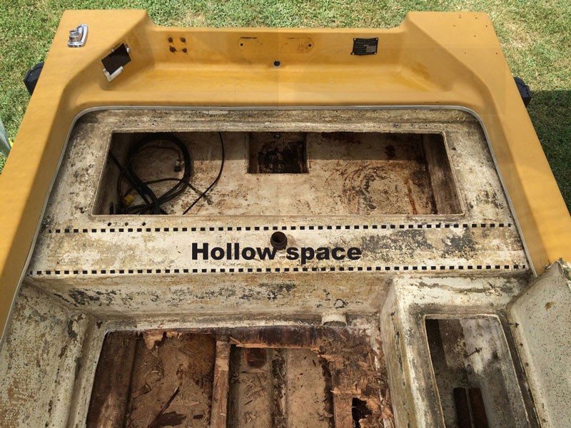

I have lots of questions about this type of design but I will cross that later. For now, I need to properly remove the entire floor so I can examine the stringers. By the way, the stringers are solid as a rock in the area torn out. I'm doubtful they will be as nice all the way to the transom but who knows. The wood forming the box that has the drain hole in it does appear to be damaged however. You can see that in the photo showing the drain hole.
My first question is this. Since the plywood runs under the compartments, I will need to remove those compartments, correct? I was wondering if there was a particular location of cuts to be made that would allow me to put them back in by fiberglassing them in place?
Then there is the live well and long compartment. Do I cut these across the back, then down the front and along the floor? And if so, do I leave a tab of about 2" on the top and front so I can realign and tab it back into place?
The fuel/battery compartment is double walled on the front side. There is about 6" of hollow space in there that the seat support drops down into. Not sure if that matters or not.

Just my .02...Looks like you can remove the entire cap that is connected to the hull under the rub rail. From that point you can remove/cut out large sections of the liner {areas you mentioned} And keep the cuts under the gunwhale. After reinstall of liner and glass work those areas {most of em} should end up being concealed when the cap goes back on.

Yes it appears that the cap would need to be cut off and then areas of the liner to gain access to the repairs you'll need. It's not unusual to have to do this,

I read your thread and seen the pictures. There is no way to refurbish this without removing the cap in my opinion. Yes you could crawl under things and work in tight places. But your efforts will go a lot further with the cap removed. And knowing that this is more a personal refurbish effort then anything else, you want it done right. You couldn't have found a better place anywhere to post such a project. The amount of quality help available to you on here is amazing. So let's get going... Everything that is rotted has to be removed and grinded down to fresh fiberglass before you can start replacing anything. This IS the dirtiest, smelliest, itchiest, crappiest part of any refurbishing effort there is. And you will need a Tyvek full body coverall suit and a quality respirator as well as eye protection too. Now they don't cost very much, but please don't do this without the PPE equipment if you value your health. You can buy the Tyvek coveralls at Lowes or HD or places like them. The don't cost very much, but protect your body from the dust that will absolutely cover everything as you grind the hull. I use a 3M 6700 series respirator with cartridges. You can buy those as well at the Lowes type stores or online for a real savings. Buy both dust AND vapor filters for the mask. Use the dust filters while grinding, and the vapor filters when you start polyester/glassing... So post your progress as you do the demolition part. We are here and will help you along! :thumb:

Ok so based on what you are all telling me, the cap should come off. Are you saying that the liner, (fiberglass floor, walls, compartments, etc) will lift out of this boat as one unit once the cap is removed?
I'm still a little lost on how I should go about cutting the cap off.

Once all the rivets are out and the rail is removed you can use a sawsall and flexible blade and cut her free. Others have had to do this. You may also have to cut down thru the transom as well. It's fiberglass so ANYTHING and EVERYTHING can be repaired and made to look NEW again.;)

I will mention that you do need to make some type cradle to support the hull once the cap is off. Because the hull will splay out otherwise and then when you get ready to install the cap back on, it won't fit. So take plenty of pictures NOW, and measurements before removing the cap. Some folks even take 2 X 4's and make cross supports to screw into the hull lip to keep it from splaying out. But they can and do get in the way. If you can build some outside supports, that would allow you to work without jumping over any inside supports. But however you want to do it is your decision. Either way works, just one way is a little more cumbersome... I built a move around cradle for my hull and it works great and still does because I haven't finished my rebuild project yet as well... :thumb:
