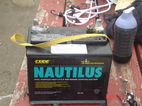

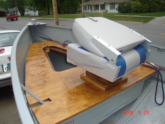

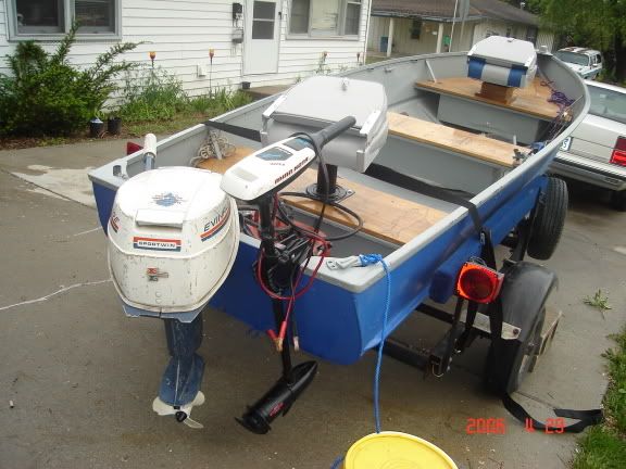

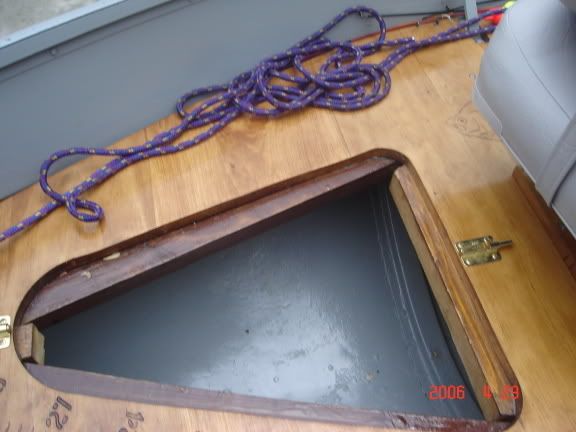

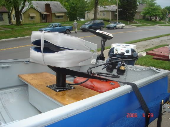

Okay my friends, a few questions for ya.<br /><br />The Plan: Construct or buy a plastic battery box and attach it to the 2x4 hatch support. I plan to utilize the wingnut posts on the battery for that connection. Extra garden hose ran beneath the middle and rear seat will provide a water proof conduit and allow for any water that needs to drain. <br /><br />My questions are: How do I create the posts at the stern of my boat so I can just use the clips that are already on my trolling motor, and what type/gauge of wire should I use?<br /><br />Here are some pics to give y'all a better perspective. I appreciate all suggestions, and Thanks for any advise.<br /><br />

How about a trolling motor plug? I've seen a couple of configurations. One is circular and mounted through a hole drilled into a vertical surface. The other is a bit like a heavy-duty 2 pronged version of a flat trailer wiring connector. Either would work - just depends on how and where you want the mount to be I suppose.<br /><br />You could rig a corresponding connector for your battery charger too so all you have to do to charge is plug the charger in where the motor plugs in if you want to get fancy with it.

jeff, your fishfinder will have a recepticle on the unit and a plug on the cord where it plugs in to the monitor - you can put ring terminals on the battery end.<br /><br />I agree with Terry on the troller - here's a plug & recepticle from iboats - you'd have to splice the plug end where the trolling motor clamps are now. You could easily fabricate a box for the plug out of wood. You could add a cigarette lighter for your GPS or cellphone or whatever - get a marine-quality one.<br /><br />If you move that motor from boat to boat, you'd have to get an extra recepticle and splice the clamps onto it.<br /><br />But a couple things to think about - the battery really needs to sit upright, looks like the floor of your bow compartment isn't level - and in the bow it'll take a pounding - might shorten its life. would it go under the middle bench? Have you thought about relocating the gas tank in front of the middle bench? Just a thought.

Thanks for the advice, jtexas. I was thinking of suspending the batt box from the hatch supports. I have thought about moving the fuel tank as well.
