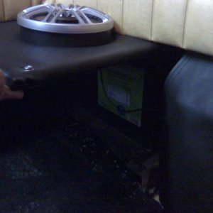

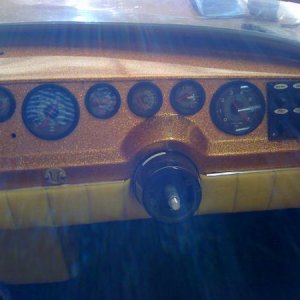

Gauges installed on dash. When I got the boat, it had a surface mount speedo, located right about where that hole is. Nothing more. My gauge placeme

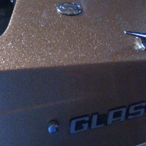

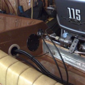

Where I put the fuel tank fill (on top of deck) and the tank vent (on side just forward of "GLASTRON")

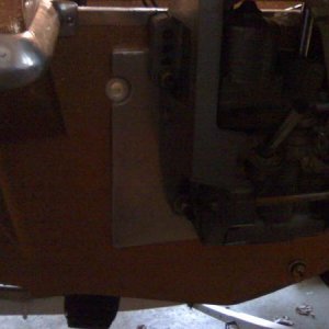

3/8" aluminum alloy plate transom beef-up.

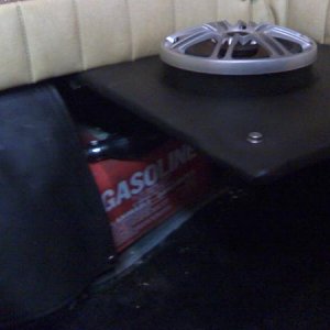

Rt side board modified to flip up allowing access to battery.

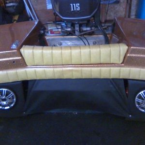

Rear of GT-150 after tank installation. I need to get a wider curtain. I had to trim the side boards to clear the tank. Yes that crease on the curt

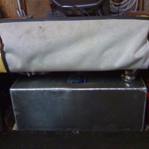

The custom gas tank I had made for the GT-150. It holds 19 - 20 gallons. Normal is a pair of 6 gallon carry cans.

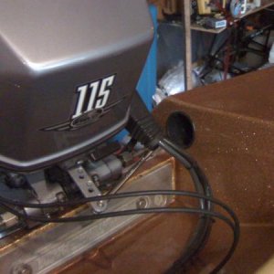

The problem with tilt tube steering on a GT-150, is the steering rod hits the far side of the motorwell. I made a recess to provide room for full ste

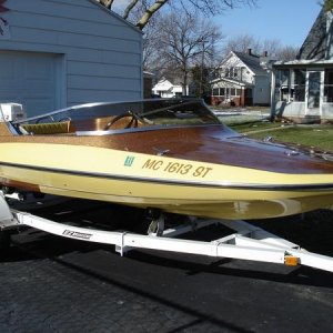

The '79 Glastron GT-150 my son gave me for my birthday July 2009. The motor is a '74 Evinrude 85 (w/o power trim).

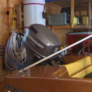

The 2000 Johnson 115 (w/power trim) I won on E-Bay.

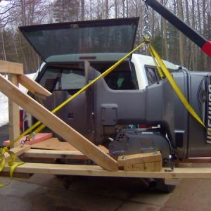

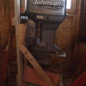

Unloading the 115 Johnson from the back of the truck after bringing it home from TN.
