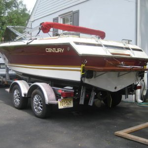

Repainted Betty Lea on Delaware River 7/30/2010
79arabian
Aug 2, 2010

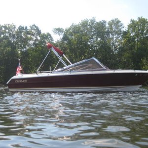

Delaware River 7/30/2010 near trenton NJ
79arabian
Aug 2, 2010

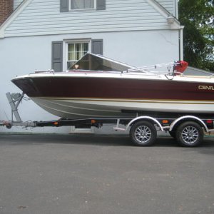

the new Betty Lea, july 23,2010
79arabian
Jul 26, 2010

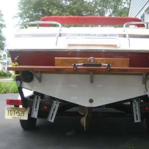

new Betty Lea, july23,2010
79arabian
Jul 26, 2010
the new Betty Lea
79arabian
Jul 26, 2010

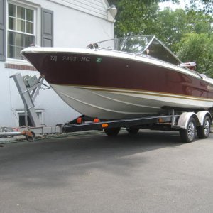

I just had the boat re painted. used Awlgrip/Awlcraft. sanded hull,primed ,3 coats topcoat awlcraft red mahogany,3 coats clear .
79arabian
Jul 26, 2010

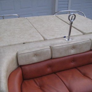

My brother and I built this new swim palt form from "Epe" lumber. 5coats of varnish.
79arabian
Jul 22, 2010

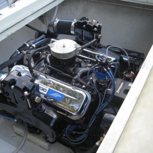

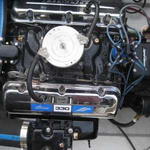

454 after total rebuild. PSY dripless shaft seal installed, fresh water flush installed for testing in drive way. ruddr and seal replaced with dual or
79arabian
Jul 22, 2010
454 after total blue print rebuild. Block magnafluxed. Align bored with torque plate. 5 angle valve on heads. Crank nitrated .030 over, Sealed Power h
79arabian
Jul 22, 2010

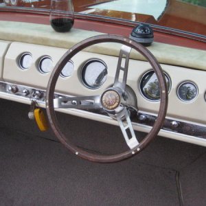

Dash completely rebuilt from back to front with epoxy resin reinforcing. All original guages rebuilt and refaced. All electric replaced and upgraded f
79arabian
