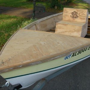

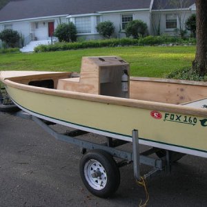

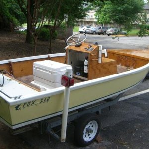

I used interlux brightside. I sanded the old paint with 220 grit, cleaned it really well, then applied the paint. I put it on with a 3" roller, 1/8"

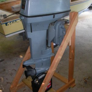

mount with motor

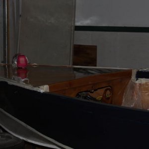

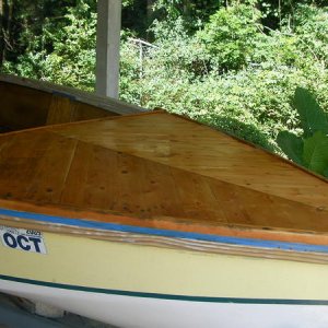

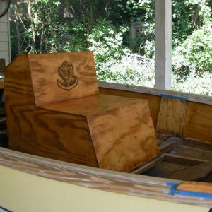

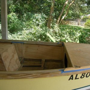

First Coat of sealant. I used a cheap foam brush to apply interlux interprime wood sealer. Great stuff, but Thinned down varnish does the same thing

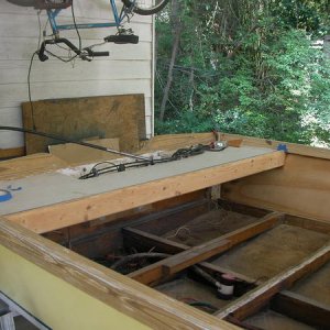

later in the project I ended up pulling of the white piece of vinyl, used a stripper to remove the adhesive, and varnished the ply under it. So glad

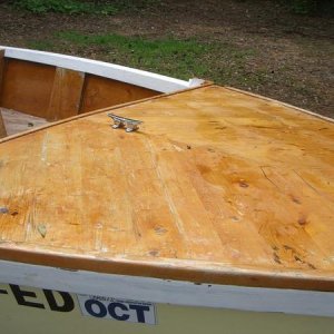

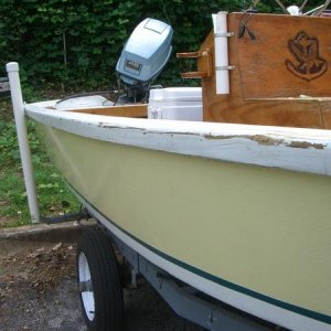

Completely stripped varnish and Stain off all the wood, and I stripped the paint off the rails. I used a chemical stripper, it was a lot of work. Th
