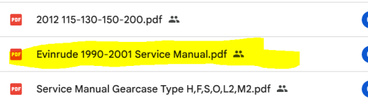

first thing is to get a manual and compare results to specs. it may flag a problem more than swapping or guessing but... ex: see sect 3.59 on injector electricaland physical tests and..NOID lamp checks
download this manual
