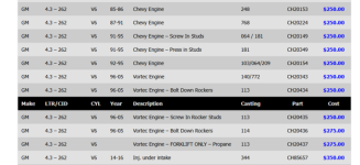

Lou C
Nov 10, 2002
14,501
More on Chevy 4.3 casting #s, I think the ones here are just the last 3 digits of the longer casting #, pulled this off of an ad selling reman cyl heads. Casting # is 3rd column from the right.
