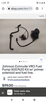

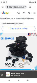

Not sure of your model but I took a guess. Part number I got was 5007420 eBay has a used one and a new one for WAY less then normal parts places. What sucks is it looks like the elbow you need is just sitting there.

Do not buy the cheap Chinese one off of eBay unless you plan on using it as a pre mix pump. Ditto with the used one. The no oil flow sensor is in the pump, so if the pump is still moving o there will be no alarm.

Not sure of your model but I took a guess. Part number I got was 5007420 eBay has a used one and a new one for WAY less then normal parts places. What sucks is it looks like the elbow you need is just sitting thete
Yes, after I posted those I read the new one was Chinese so I agree. What would be wrong with the used one? He could probably just steel the part off it.
