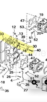

That missing bolt does not cause compression issues in the crankcase.---And it cannot cause fuel to leak elsewhere in my opinion.----Find the real issue.
It may be causing an air leak in these 2 little holes right beside the stripped bolt. I’m no OMC tech but just a thought? IMG_0480.jpeg
jimmbo
May 24, 2004
13,648
Check the Gasket for those holes, they are likely part of the Oil Recirculation System
