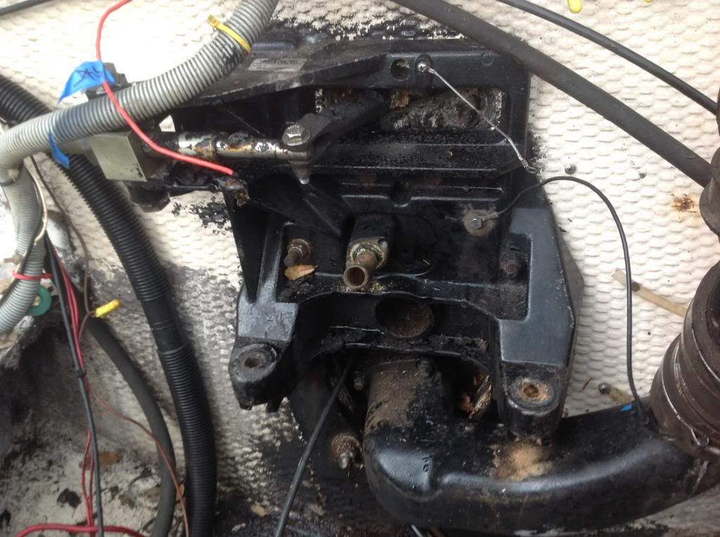

Not the best picture... but here's one of my project boats with the engine out. The big pipe you see is the exhaust pipe. It is bolted in with the 12 point bolts you mention.

There are variations on the bolt placement that I have seen - but you will have at least four. Here's pic of a transom assembly with the pipe removed:
