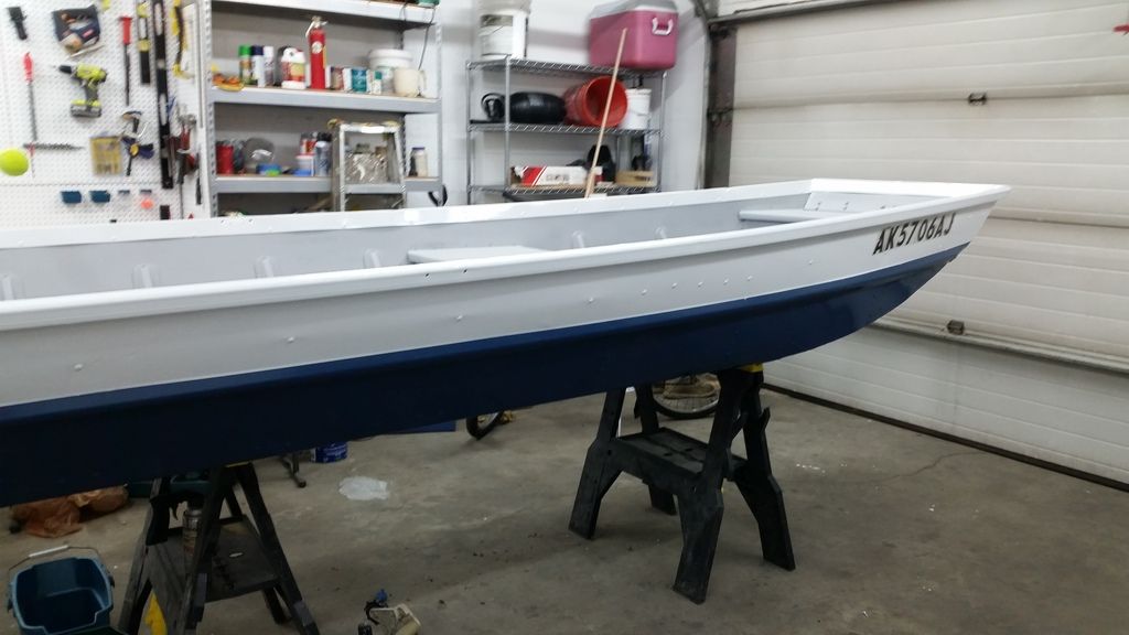

Got the SE priming done tonight and then the first coat of the hull paint - Rustoleum Royal Blue with a couple splashes of black in it! super happy with my little custom color job, the royal blue was just to "neon" for my tastes

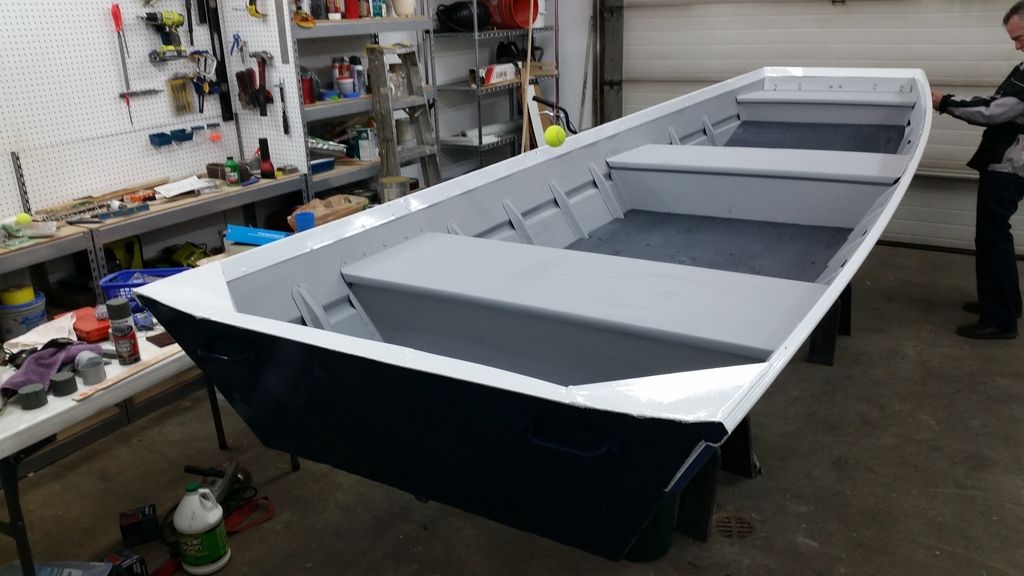

Update: I got the second coat of paint on the top half, went with a gloss white. I also painted the interior with just Rustoleum SE primer and then standard rustoleum grey primer, and then a dark grey latex enamel my dad had laying around for the floorboard (3/8" ply on 1.5" Bluefoam). I think Im going to do another coat of white on the gunnels, It just is a high wear area and doesn't quite have perfect coverage. Not necessary, but I think I'm going to do it.

Update:
Paint is done! I finished the last coat last night and just had to take off the tape before work this morning. Shes a beaut!!
Thee title decals are printing today, I'll pick them up tonight. I might wait another day to put them on? I don't know, does anyone think the enamel might have a tough time drying through a vinyl decal? Might just give it time just in case.

So for the inside, I used just Rustoleum's Fast drying Grey primer. It looked almost white when I put it on! Wish it was a little darker, it might get dirty with all the fishin I do, but it's not worth keeping it out of the water any longer!!
