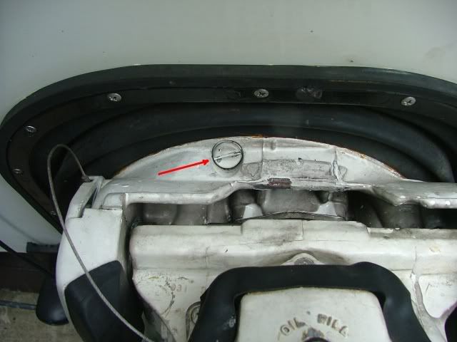

There is a flat screw plug, about the size of a dime, at the top of the intermediate housing right outside the boot. You may need to stick a straw, with your finger on top of it, into the hole and pull out some fluid and dump it in a clear glass for inspection. There is no drain plug for those years. <br /><br />There is a seal behind the ball gear and a seal inside the intermediate housing to keep oil in and water out. If the outside seal is leaking it might be forcing emulsified oil out of the inside seal and down into your bilge.<br /><br />The only other place the 'oil' could be coming from is the engine.

Check this. If you do not have one of these plugs, then your drive shaft bearing is lubed by a zerk fitting instead of 90w oil. Not sure what year they made the change over. This pic is of a '75.<br /><br />If your unit is lubed by grease, I doubt that it would create 'creamy oil' in the bilge even if the seals were leaking.<br /><br />

Pictures are worth a thousand words... and sometimes, dollars! Thanks. <br /><br />I'm pretty sure I don't have that plug though. I'll check again after work...<br /><br /> :cool: Thanks!

If you don't have it then I suspect your unit is alot older than '73-'74. But come to think of it, even the units that used grease have some kind of a top plug. You needed to remove the plug to keep from blowing out the seals when you applied the grease gun.

Okay - I do have the plug after all! I dipped a straw just a little bit down in there (couldn't get it down too far at all, maybe an inch or two), and pulled out some oil, marbled with the "creamy" sludge. Since I'm not seeing any leakage on the outside of the nuckle gear, I can assume that the "inner" seal is failing? If this is the case, I see three bolts on the outer housing above the exhaust port. Can the assembly be removed this way or am I going to have to remove the whole outdrive to replace the inner seal?
