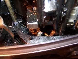

Also theres about 1/2"hole on the block i guess, up under and behind the number 6 carb that looks like something blew out.any idea what could have went there?its hard to get a pic of it with it all togeather.
