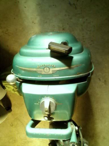

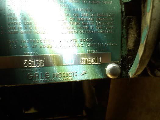

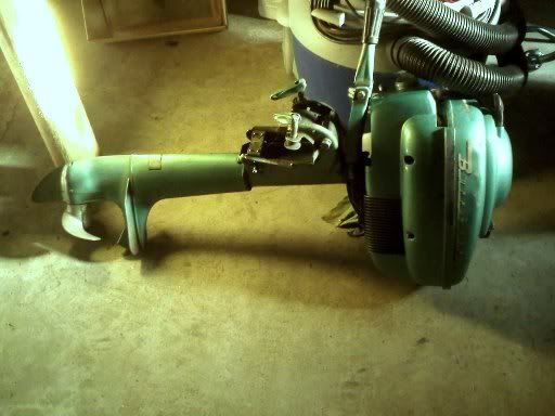

I just bought this little engine from an antique shop. It may be worthless I don't know...but it was cheap and looked fun to tinker on. My question is does this little engine have an impeller? The leg looks so skinny I dont know how they could fit one in there! Also any leads on parts diagrams?

What a beautiful looking motor!! If you don't want it, send it to me.
The impeller (properly called a "rotor") is forward of the propeller. It should be a close fit on the eccentric and just touch the housing as some point. It should have a space on the opposite side. As the shaft turns, that space appears at the inlet hole and progresses around to the outlet port, where it disappears. That moving space is what grabs a gulp of water at the intake and moves it to the outlet. The rotors swell up from exposure to grease and that closes up the space.
Whatever you do, DO NOT remove the water covers from the sides of the powerhead!!!
Pump rotors are available from Brian Wilcox. http://www.chrystine.com/impellers/order.html

Thanks for your help. I was wondering what those plates were on the side. I never saw those before. These little outboards do have a lot of character. Do you have one yourself?
