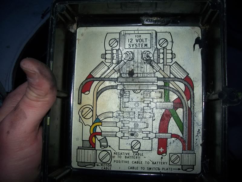

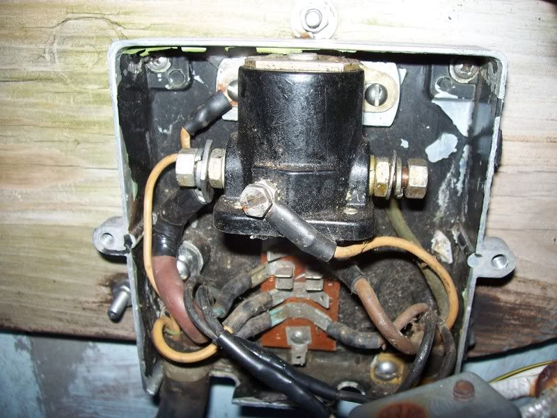

He also said it used to be 6 volt and was converted to a 12 volt. Is this common or even true? Here is a pic of what is in/on the electronic box...
If it is in fact an old 6 volt system is there anything I have to worry about it?

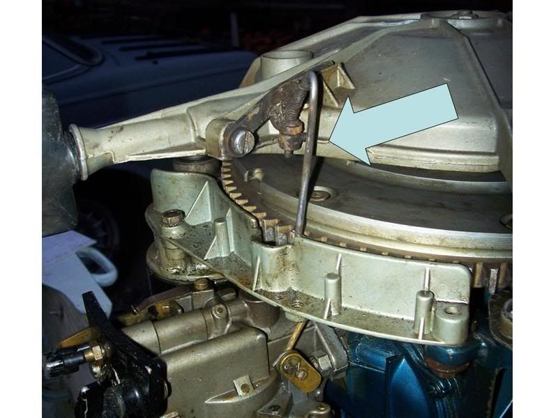

I found a misc. linkage part in the bottom of the boat, and after playing around I found out where it used to go. I've temp attached it (see big arrow in pic below), but does anyone know what it is for and if I need it installed again as the bottom half of it is mangled and doesn't fit anywhere anymore.

That was a 12 volt system from the start. Even my 1958 35hp was 12 volt. Do clean up those contacts, though on the junction box. Clean up the contacts on the plug and receptacle on the engine, as well. It'll save you lots of troubleshooting time.
I can't remember what that link is for. I don't have mine any longer. For now, you can remove it, I believe, especially since it's mangled.

Picture this scenario, if you will. You are out on the lake, running along at full throttle and you run out of gas. So you hook up the spare tank and squeeze the bulb. Ready to go...except the electric starter won't crank. OK, no problem, you stand up and give the recoil starter a mighty heave. The motor starts instantly. But oh-oh, remember it was running wide open and in gear when it quit!! And you didn't pull the throttle back and put it in neutral--that's why the electric starter wouldn't crank. And now, here you are, standing up, off balance, and the motor suddenly starts. You are going to go flying right out of the boat as it takes off. You were alone, so there was nobody to shut down or steer the boat. Unless it runs aground first, it will always go around in a big circle. Guess who's in the circle? You are. The boat runs over you and then comes back a few more circles to make sure you are dead.
The linkage you are considering throwing away locks the recoil so it can't be pulled at throttle settings above fast idle. That prevents you from doing the above situation and dying. Put the dang thing back (or a new one) and adjust it properly!!!!!!!

Chinewalker is right, 12V came in 1957. So it was always 12V.
Looks like it has been converted to electric start as Steve suggests. That's a nice add-on. Lots of posts on here about converting old motors. Consider yourself lucky.

The linkage running between that bracket and the flywheel would scare me! It appears to home made. Here is a picture of my 55 RDE with the correct setup. I would bet that it would be the same for yours. Or at least similar.

Scared or not, the 35 had a linkage made of thin stainless rod, as in his picture, except his is bent. Yes, your 1955 25 and earlier had the cast link.
