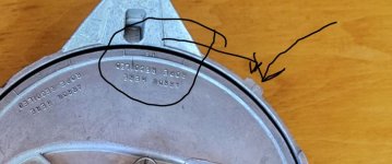

Crosbyman
Nov 5, 2006
5,935
when recoiled the small arrow should be lined up with J ZONE for Johnson models
JOHNNY1963
Jul 6, 2021
7
I am using the same rope as I was before when it was working properly.
When I wound the spring, I lined up the arrow within the JF range. Once the rope is recoiled it ends in that spot out of the range.
39,239
When it is lined up it is easier to pull over.-----If you are able bodied / high school wrestling champion this alignment does not matter !
