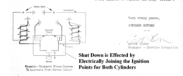

4. Kill circuit is the two black wires coming out from under the magneto.

Just looked closely at the pics - Your motor had factory electric start. Solenoid should be in the cowl pan. It would be fairly easy to rewire it to bypass the remote cable hookup if you can't find the cable. Had a key start. Turning off the key would kill the engine. See Crosbyman's diagram.
Ok so basically all I’m missing is the key switch and the remote choke switch on the diagram.
