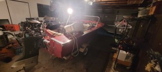

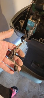

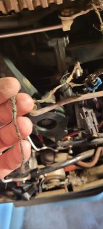

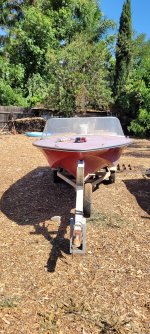

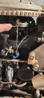

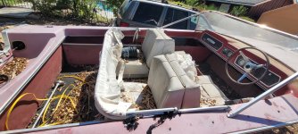

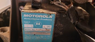

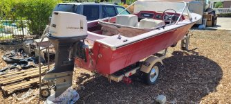

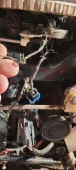

I am new to this stuff. I worked Saturdays towards an old 69 Chrysler/Lone Star boat with 69 Johsnon 55hp on it. The wiring on the Motorola Amp is fried along with a few others I know nothing about. I got this boat because my boss didn't have money to pay for the help he NEEDED and was trying to sell it to pay me. I decided to help him in exchange for the boat thinking id sell it later. I started cleaning it up and fell in love. My grandfather used to work on and sell boats after he left the navy . He worked all the time and never really had time to spend with his family. Ive never owned a boat. Therefore i never really had any opportunity to seek any of his knowledge in this direction! It feels like he wants me to fix this 1 !! So I'm seeking any and all suggestions for this particular project here from you all. If you have any tips or suggestions that may help please feel free to contact me with info! Thank you in advance! Dan.
