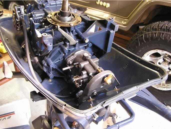

I'm rebuilding my Dad's 25hp Evinrude. I plan to use it on the boat I'm building. It probably hasn't been cranked in 10-15 years, but was running fine as far as I know. I'm ordering a shop manual after this post, but I thought I'd get a head start and at least start to tear it down. I got the flywheel removed. What a pop when it finally breaks free! But I'm missing something when it comes to removing the carb. There physically isn't room to get it to clear the two bolts and the lower part of the cowling.
Do I need to remove the front part of the carb (silencer cover area)?
How do you remove the bottom part of the cowling?
This is my first post on this forum, so I hope my link below works.
Thanks in advance,
Doug,
Raleigh, NC

pull the knob off the needle, remove the screws from the plate, disconnect choke lever, take out bottom needle valve. remove nuts and carb comes out.

Thanks for the help. I got the carb off and it looks pretty good. Just took the float chamber off, cleaned everything, and made sure all the springs, valves operate smoothly. I wish I would have taken a close-up pic of the needle valve before I removed it, so I'd have a good starting point on where to replace it. Hopefully the shop manual I ordered tonight will give the details.

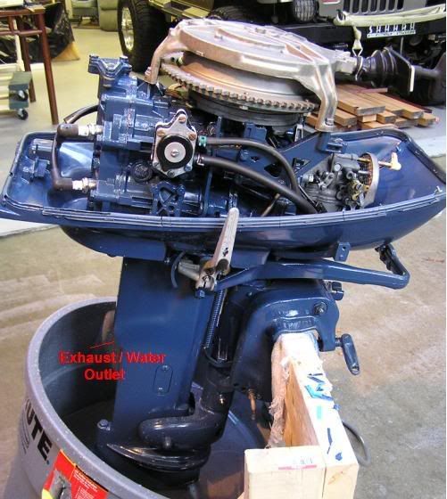

I then removed the power head. I've cleaned one side as you can see in the picture below. Is this normal buildup?
Also, here's a shot of the ignition parts. Does anyone know of a good online retailer that sells a complete tune-up parts package? What should I expect to pay for it?

Those coils are newer and will probably still work fine. I'd just clean and gap the points. (but I'm known to be lazy that way!)
The carbon on the pistons can be scraped off gently. As long as there are no scratches or grooves on the sides of the pistons or cylinders, just remove the carbon best you can and you're good to go.
