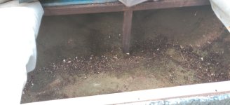

Deck engine hatch drip/drain channel

This shows the depth and generous grade of the channel

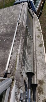

Railing buttress. Rivets are so quick, compact, light, and convenient. Get yourself an air riveter.
