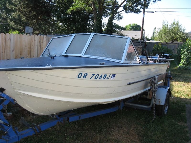

So I bought this boat, lets just say I didn't steal it. First attempt at boaterdom, didn't want to spend a lot, didn't really want a project. that was then.
So please admit me to the Starmada

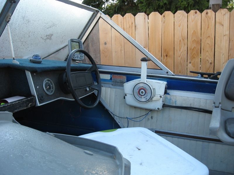

Replaced the gear selector in the Power Pilot, easy enough, got the 50hp Evinrude running okay
Needs a new transom
So I got me some questions
Should I remove the splashwell? I've seen a bunch of threads and it goes both ways.

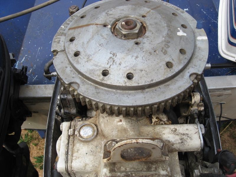

Can I remove the motor with a cherry picker using this lifting ring or do I need to use the flywheel threads?
How to remove steering cable?
The plan is to replace the transom, use it, catch some salmon, restore the deck, use it, maybe buy a bigger boat some day.

Welcome to the Starmada places, great looking Holiday you have. My opinion is it is easier to do the transom and seal the splash well if you remove it. The lifting ring will work to lift it off, but re-installing it is easier with the flywheel holes, as they hold it level. The steering cable is removed by loosening the large nut of the tilt tube on the starboard side of the motor, then take the 3/8 nut of the steering arm on the port side of the tilt tube. Then when you lift the engine you can slide it to the port side to get the cable out off the tilt tube.
