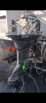

Another thing I noticed that was different from before I changed the head gaskets was a fairly decent amount of water started coming out of the holes pointed at by the red arrow. (picture attached) It was coming out of both of those holes but only one at a time which was kind of odd. The service manual doesn't really do a good job of explaining what that hole goes to. Any thoughts on if this is a good or bad thing? I'm guessing thermostat but not sure.
I also have a water leak coming from the green arrow on picture attached. This leak was there prior to doing the head gaskets. I haven't taken the lower off yet but since we are on the topic of water coming out of odd places I figured I'd throw this in as well.

Probably right. I'm going to try and get a season out of this then part it out. Any ideas on why the water would come out of the hole I pointed out with the red arrow?
39,225
That is the idle relief.----Normal for water to spit out at idle.----Lots of water comes out of those 2 holes at full throttle.
