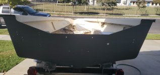

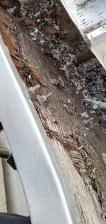

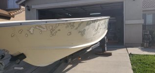

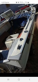

So i picked up a super cheap boat that i know needs alot of work but seems like a boat that will be great for the rivers and lake i go to. Started the tear down the first day and haven't stopped cleaning and prep work. Have questions and think alot of new boaters that come here will have ideas to play with . So here i go .
Paint: on a small boat theres alot of different paints around to choose from and the price not bad 90% of painting is prep work turns out great when time gets put in .
Floors: way are they riveted to the ribs? Why not use aluminum flat stock all the way around the boat and rivet it down to the ribs making a hard edge for your floors to sit on and use rivetnuts to screw down your floors . You could pull floors if you get a leak to run wires a whole world ideas If anyone out here trying this please do tell
I posted my work in progress and i mean work. Thanks for your time and pointers .

A small handful of members have tried riv-nuts but i dont think many (any?¿?) reported satisfaction w them. For sure I remember 2 that found them a complete PITA to deal with. User/installation failure, maybe.... dig around the resto & starcraft forums, its in there somewhere, wish I had a better idea who used them...
Similarly, the very popular to try/talk about aluminum brazing rods have a very spotty track record posted here too.
post some pix of the new to you rig, cant have too many pix posted here documenting your efforts.
Good luck w your project
Oh, and the rib ends arent flat w a rivetable spot at the decks edges to mount flat stock to and have a flat surface to lay the plywood deck down.
You'll need riv-nuts along the seams between sheets. Plus dont riv-nuts leave a shoulder between the 2 surfaces you're riv-nut/screwing down which may effect drawing the surfaces together and allowing sufficient clamping force alone an edge?
Not sure the thin edge of a stringer allows sufficient grip for a large-ish riv-nut shaft vs a 3/16in rivet.
Once you put the below gunwale panel back on and attach it to the deck, no access to your riv-nut screw. Once you put the consoles, windshield, seats and bow seats back in, not much point in an easy to remove deck, if ya have to peel the whole onion to get it up anyway.
And lastly, read up on rib end and chine cracking, you'll want to examine/inspect those areas carefully

Oh boy that transom was mulch.
The decking fastener standard is the LF blind rivets but others have used screws instead. Not sure about riv nuts but it also depends on your preference on deck covering and method. Some of us have countersunk the rivet heads and put vinyl deck covering over them to make a completely sealed surface

Oh fun!!! Looks like a SS16. Fun little boat when you are all said and done.
Flooring: Never thought about doing a removable floor. So much is secured on top of it that removing it to run some wires would be a lot more effort then it would be worth in my opinion. Plus that is what the hooks under the gunnel are for.
