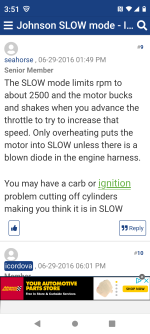

Not sure 3500 would be considered a "slow mode" my outboard, while quite newer, takes me down to 1200 rpm's. Seems like 3500 if your running hot or low oil wouldn't be very "safe" did you read somewhere that that is the safe or slow RPM? Here is a screen shot of something I found with a comparable motor....I think your problems are elsewhere perhaps even under the flywheel. Be persistent and try to be systematic and you should find a solution.
WOT on this model is 5000-6000 RPM, and she regularly would hit those values until last weekend. 3500 RPM seemed in line with other posts ive seen, the tell tale engine bucking / shuddering (its very distinct). I am so positive it is SLOW mode although of course I can't know for sure.
From everything I've read it 2500 for your motor. Did you read about the diod that can go out in your harness and cause it?
