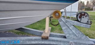

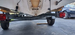

I didn't have the space to build a cradle so I supported the hull where I assumed it wouldn't flex but, in my rebuild I didn't remove the cap so I'm not sure it would be suitable for you.
I can say that it had been said take measurements on everything and possibly bracing so your sides don't splay when cap is removed.
If you search the forum I'm sure you'll find alot of threads on this subject and read the stickies at the top of the forum for excellent information on rebuilding your boat.
