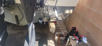

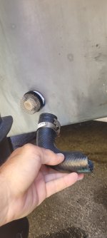

I don't remember exact speed at wot I think it was around 35. Yesterday I did remove the speedo sending unit(using GPS for speed anyways) and moved the TM165HW transducer in its place to the right farther away from the engine. I also removed a supply L-shaped hose that was installed for the live bait tank right behind the starboard motor to get raw water while running without using the pump. All these I think were creating interference and triggering the over revving issue. Too many things there causing the cavitation. I have to test it. On the port side there is only one transducer and no over- revving.
So now instead of 3 things getting in the way there is only one transducer.

Ok good news, the over revving was caused by the clutter behind it. So, removing the big hose and the speedo sending unit and moving the transducer to the side did the trick. And it is a good thing because the other engine decided to quit on me, so I had to use this one to get back to port. It actually got me to 20mph. I replaced and clamped all the hoses on the other one, removed and cleaned the fuel pump that was all gunked up, replaced the membrane also and it started again. Maintenance is key that's what they say.

So wanted to update on the over-revving issue. I had lots of clutter behind the affected engine, and I removed the supply hose for the fish tank (see pic), the speedometer sending unit since I use GPS for speed and also moved the transducer further to the right and installed the 4 blade 15p back on, that was successful as it no longer over revs. So, the clutter is a no no.
Didn’t see that in the original pictures.
99.8% probability that was your problem.

There is a picture of the hose up above. It was placed there to scoop up water while going.
