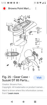

Hello
Looking for some help. It looks like someone has stolen my propeller. Could someone help with what I am missing? I've managed to source a replacement propeller but what else I am missing. Spacers, nut?
Thanks.

look at a parts breakdown of your motor, it will show what is needed, or just drop by a Suzuki outboard dealer and they should be able to look it up for you

Here's what most would have in order.....thrust washer, prop, splined washer, nut and cottor key.
I don't see any of those on your shaft.

Hi thanks for your reply. I managed to find a local Suzuki dealer and he was most helpful. Got the parts on order.
