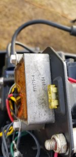

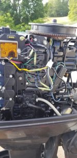

Just wondering if someone can help me with this diagram please any help is appreciate it.
I just rebuild the engine but now there's no spark.

1995 they did not have CDI ignitions anymore but the Mercury switch box please see pics below and let us know what you have;

Is a 1995 bayliner capri 1800ls
no serial number sticker is off, only number that i found on the block is
900-817609
No spark after rebuild, but the problem ended up being the rectifier
any suggestion on witch rectifier works for this engine?
Thanks in advance
