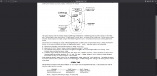

Found what your describing, that tester is only for checking the operation of the infrared emitters and detectors in the actual optical sensor. Not for timing of any sort.
And you are correct, Joe Reeves method does not work with my engine, the other method did work very well though.
BUT, THANK YOU!!!!!!!!
The PDF on the tester I found at CDI not only had the operational description of the tester, it also listed the timing specifications for my engine!!
Here is a photo of that PDF

No the analyzer is used to time the engine!!! I have the exact same motor with the factory manual.
