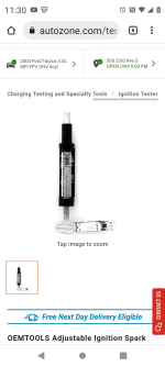

Update... Bought spark plug tester. Found no spark on 1 cylinder. Tested ignition coils and found low resistance on a 3 month old coil.
Trying again in the water this weekend.

0.2 and 200, I wasn't getting a spark from the coil with those readings.
That was on an aftermarket coil that was 1 month old. Next purchase is a genuine coil!

My other aftermarket coil is reading 0.2 and 375... Much better
