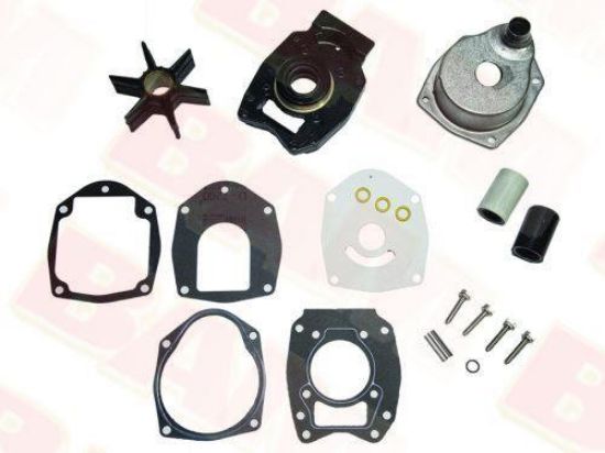

Hi Guys,
I want to replace the gaskets and impeller on my 1998 Force 120 but the boat shop only has the full water pump kit which is like $350.
I just want new gaskets, and an impeller.
Does anyone know the part #'s for the gaskets and impeller?
I can't find a kit with just that in it.
I think it might be the 43026t2 impeller kit? But does that have all the gaskets I need?
L3af
Aug 2, 2023
38
Gaskets can be made.
Go on... :p
I believe this is the kit I need. I assume the kit is for multiple motors though.
I believe I need:
#34 (Impeller) New Part: 43026T2
#28 (Gasket) New Part #: 27-8172771
#24 (Gear Housing Gasket): Part #: 430331
#25 (Gearcase Gasket): Part #: 430472
I've never done the impeller replacement before so please someone tell me if I'm wrong and should get the entire kit or if I'm missing any parts that I need to replace.
The kit also includes a gasket part # 8M0050720 which I don't see I would need in my diagram?
Is there a way to order these parts cheaper separate?
