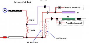

White wire to blue/purple/green is shorted on 5 out of 6.

Purple/grn on same side are cylinder #4 and #6 and controlled by advance coil..so diode or resister failed.
