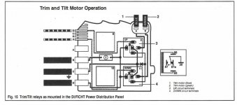

see basic 2 wire trim

btw what was wrong with your PDP ?? the bottom D input feed of 12v has a history of cracked or cold solder joint easy to reweld if you are handy at this.
since your T&T relays get their +12 source directly off the PDP it is possible your PDP is still defective. It may let enough +12 to be distributed for lesser amperage hungry ept...but not your T&T motor. see if anything happens if you tap the panel itself while trying to trim.
here is a better shot and has you can see there is not much between a strong +12 DC input at "D" and output of DC and GRD distrubution ..... from the relays to the trim leads.
