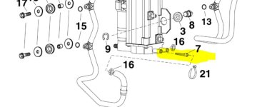

one sneaky critter is the VST conical filter not shown on 2005 diagrams.....
it can be clogged from soft fuel line debris with age and the EMM would not know.
VST nipples are very easy to crack PROCEED WITH CAUTION if you plan to inspect this $2 part which blocks fuel flow returning from the injectors !!

After initial launch I determined my port HP Fuel pump was bad, I disassembled the VST (which was beyond dirty), cleaned it well and replaced the screen on the injector line and HP fuel pump. Costs were <$100.
Now both engines are running very well, so far I am pleased w/ my purchase.
