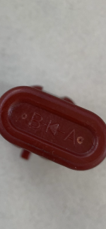

i started it and ran it until it shutdown. Roughly 3 min. Then disconnected the Tks , it started and ran for less then a minute then shutdown … I can continue to start it and it continues to shutdown. The fuse has not blown which is new. There is a red terminal next to the tks that is pretty hot. Not sure if that factors in but thought I’d share.

Would like to see the red terminal that is getting hot

Thats a diode. It may ok but something is drawing to much current. If it cools down after the module is unplugged then its just the module. If it remains hot then might be the temp switch
