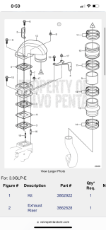

Should I consider adding the 3inch spacer at the elbow. I have been a couple other threads the day when you snap the throttle there may not be enough exhaust pressure to keep some water out. I am wondering if this is my issue. I attached diagram.

Well if anyone is interested I’ll post my thoughts as far the problem and try to attach YouTube video. So I think I have a sticky valve problem on the 4th cylinder. I suspect the exhaust valve is staying open after the piston has reached TDC and on its way back down causing vacuum to be created to suck a little bit of water back in the cylinder which in turn caused the misfire. It makes sense. Reversion YouTube link. This video has to do with aggressive cams and overlap of the valves but definitely put me on the right path and got the wheels turning in my mind.
So to try the easy road I am going to run some seafoam through it when I take it out this weekend. If that doesn’t work I will pull valve cover and check rocker arm and tap on the exhaust valve.
