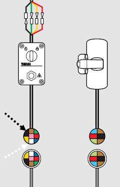

First, do you have a lanyard or emergency shut off? Does it work? If not, you'll need a multimeter or an ohm meter. Check for continuity between the back wire on the ignition switch and the negative post of the battery, or any bolt head on the motor. If the ohm meter doesn't read "0" then you have a shorted out ground wire. The easiest fix for that is to either run a single black wire from the ignition switch to the battery, or cut and connect the black wire from the ignition switch to any other black wire in your dash board (after checking for continuity between that black wire and the battery "-" terminal. Continuity means no resistance, or a good "connection". I've attached a couple of images to help you out.
